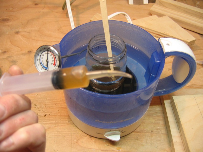

I tried a brush but had poor success. You have very little open time with hide glue, I have found, from my limited experience that it is best to get the glue on and the get piece in place as fast as you can. Cleaning off the squeeze out is very easy after about 10 minutes, it just rolls off with a dull chisel.
I use syringes that I got from a friend of mine who is one of the veterinarians in town. I use the set up that Sylvan Wells discusses on his web site and from a couple of questions I asked him directly. Plus I read all of Frank Fords stuff. (Thanks Sylvan and Frank!)
So here is my set up:
This is my set up, a kettle I bought from Wal-Mart for $20 CDN and I bought the thermometer from there also for about $6. I keep the temperature at about 145 degrees. I find that on the lowest setting my kettle heats up to about 165 right after I plug it in, but if I then unplug it and let it cool to 140 and plug it back in it stays right at 145 degrees.
Here is a shot inside the pot. I mix up small batches of hide glue (I sell the stuff now also, 192 gram, high clarity) at the ratio of about 1.8 parts water to 1 part glue by weight. I mix it in a baby food jar, using Franks instructions of soaking the flakes for at least 4 hours and then 'cooking' it. When I am done I put the lid on the jar and the glue goes in my beer fridge. You can see the syringe in the kettle. I just draw glue out of the jar into the syringe by pulling back on the plunger and then leave the syringe in the water. When I am ready to use the glue I take the syringe out of the water, shoot a small amount of glue into the glue jar to clear any water that might be in the end, then wipe the tip with paper towel and apply the glue on the piece to be glued.
Here is a close up of the tip of these 'anal sac' syringes. I leave them as they come but you could cut them back if you wanted a larger hole. They tolerate the hot water very well.
When I am done glueing, I shoot all of the remaining glue in the syringe back into the glue jar and the then draw and shoot water out of and into the kettle a few times to cleen the glue out of the syringe.
This is my process and it is working well. I tried brushes and glue bottles and didn't like either. The nice thing about syringes is they work with vaccum. If you don't depress the plunger no glue comes out, you have total control!
